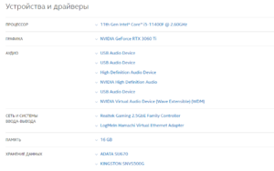

Оперативка hyper hyperx fury
и два ssd (ADATA и KINGSTON)
